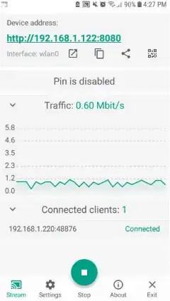

Screen Stream over HTTP
A nice open source alternative, also on F-Droid.

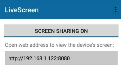

LiveScreen
Easy and no sign up crap. Just install it and on the app switch screen sharing on:
Then on your browser (hopefully Firefox, or Brave) pointing to your mobile's IP:

Screen Stream is another app that can do this. You install the app on your Android device, and then connect to it through wifi (or optionally 3G) from your PC using a normal webbrowser.
Internally, the app captures the screen and sends it as a MJPEG stream to the browser. It is not super-fast, so unsuitable for video, but it works well enough for showing other stuff.
The app is open source and available from F-droid and the normal Google Play Store
