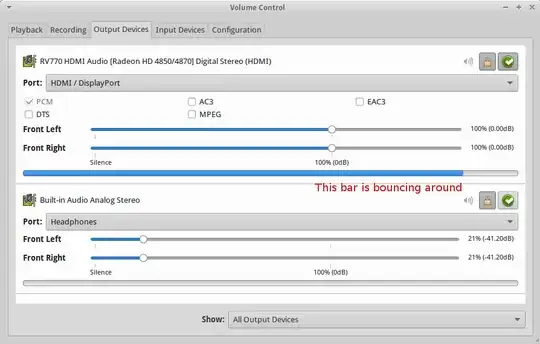

Viewing the PulseAudio control panel, it's putting sound out the HDMI

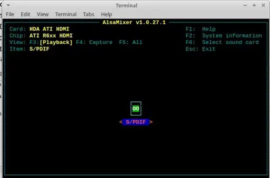

Alsamixer is not mute
