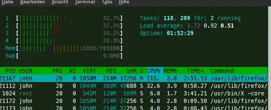

This is my htop output when I watch something on Twitch:
I use Firefox. When I watch something on Youtube, the CPU%-value is at about 10... or 20% (I installed Intel support via a PPA, which I took from a guide on webup8.org) . Besides that, the video at Twitch is stuttering, it is practically unwatchable.
  • Is there a problem in the way I set up this Intel graphics support for Flash?
  • Or is there a problem with Twitch's Flash stream?
Either way, is there a way to improve the performance when watching something on Twitch?
