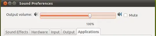

How come the maximum volume on the sound menu isn't actually the maximum volume possible?
If I select "Sound Preferences..." and look at the volume slider in the window, it can go quite a bit higher. Why is this and what is the point? What I do know is that audio can distort past the normal 100% level in most instances but it's fine for when I'm playing DVDs.

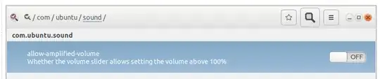

Or, on Ubuntu > 16.04, whether the Sound Settings control panel volume slider allows setting the volume above 100% is controlled by the following dconf key. Run the following command to disallow setting the volume above 100%. Change takes effect immediately.
dconf write com/ubuntu/sound/allow-amplified-volume false
This setting can also be done from the dconf-editor:
