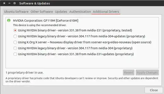

1. Use nvidia driver
Open the dash (super/windows key) and type in "drivers". Open "Aditional drivers" Select the nvidia binary (331.xx) driver.
nvidia driver
Click "apply changes". Wait for the driver to be downloaded and installed, and click close.
