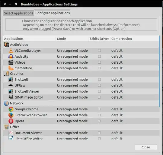

  1. in Bumblebee Application Setting program, I set few application to be run on Performance Mode but it get reset to Unrecognized after I close the application (see image below) bumblebee applications settings
