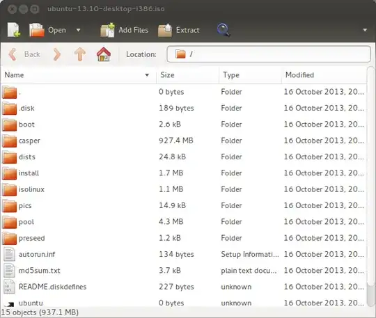

In Ubuntu, you can open them in Archive Manger:
You can add files .isos, and extract them.
To open it, right-click on the file and select Open With →, and Archive Manager. If the option is available, you can also mount the .iso image as though it was a disc in the computer.
If it is not installed (it should be, I think it is part of the desktop), use this:
sudo apt-get install file-roller
You may also get an option to right-click and Extract Here to extract the contents of the iso files, and other compressed files.
