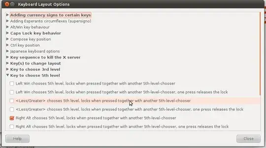

There is an option to specify a key to be used to access 5th level on the keyboard in gnome-keyboard-properties ("Keyboard" under Hardware in System settings):
Screenshot of said dialog
But if I set the 5th level to AltGr and the third level to Right Ctrl and if I set key 54 as follows:
xmodmap -e "keycode 54 = 1 2 3 4 5 6 7 8"
I get following results from pressing different variations:
keycode 54 = 1
keycode 54 + right ctrl = 5
keycode 54 + right ctrl + shift = 6
keycode 54 + shift = 2
keycode 54 + AltGr = 1
keycode 54 + AltGr + shift = 2
  1. So what does the 5th level modifier do?
  2. How do I set it up so that I can get 5 or six different characters out of a single key (modified by Shift, Alt Gr and Right Ctrl for example)?
