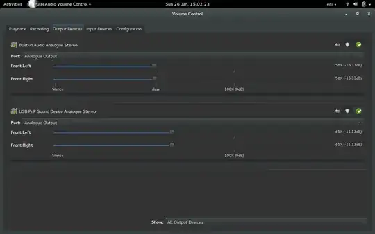

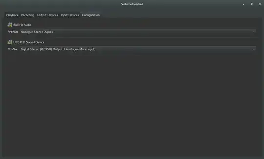

Seth
  • 59,332
  • Install Pulse Audio Control
    sudo apt-get install pavucontrol
  • Only playback record (no microphone)
    Open it → Input Devices → Show: All input devices → Use Green Button to the right to Select "Monitor: Analog Audio"
    There are different channel names but You can run some player and see which has signal.
    When Gnome Volume Control is opened, It overrides it back to Microphone. I have noticed that in the late releases 13.04, 13.10, 14.04. It cannot be changed back using Gnome Volume Control. (Avoid using it on recording)
Pulse Audio Control : Input Devices

  • In case, Unable to find a Playback Analog Monitor in the Input Devices
    1. Check Configuration tab, it should be Full Duplex (Input/Output)
    2. Otherwise, It is possible to create a virtual output device then loop it back.
      pactl load-module module-null-sink sink_name=Virtual1
      pactl load-module module-loopback latency_msec=1 sink=Virtual1
    3. Then use Pulse Audio Control, Same step above to select the correct input device Virtual1.
    4. For output device:
      • Use Output Devices tab if all mixed system output needed.
      • Or use Playback tab if only some application output needed (like: just VLC music play ...). In this case you can record somethings and listen to somethings else.
