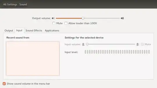

I cannot get any sound Recordmydesktop
by sound I mean the background song or video volumes which are ongoing in my desktop
I have a video of what I am doing to get sound but eventually not getting it its over here

  • This is to record Playback Only (no microphone): Number are same on screenshot.
    1. Goto Input Devices tab
    2. Show: All input devices
    3. Use Green Button to the right to Select "Monitor: Audio Analog Stereo"
    There are different channel names but You can run some player and see which has signal.
    When Gnome Volume Control is opened, It overrides it back to Microphone. I have noticed that in the late releases 13.04, 13.10, 14.04. It cannot be changed back using Gnome Volume Control. (Avoid using it on recording)
