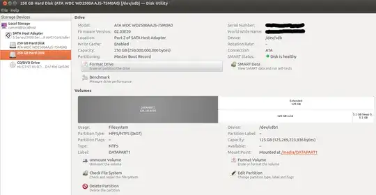

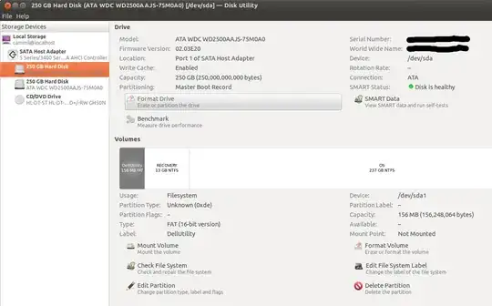

I am confused about what hard drives and partitions I actually have, and where each OS is. I am not even sure if I have one or two physical hard drives. Here are screenshots of my drives / partitions.

Would you go to this site and follow the instructions on how to get the boot-info URL to post? https://help.ubuntu.com/community/Boot-Info
I will be able to look at everything I will probably need to see to help you troubleshoot this better.
