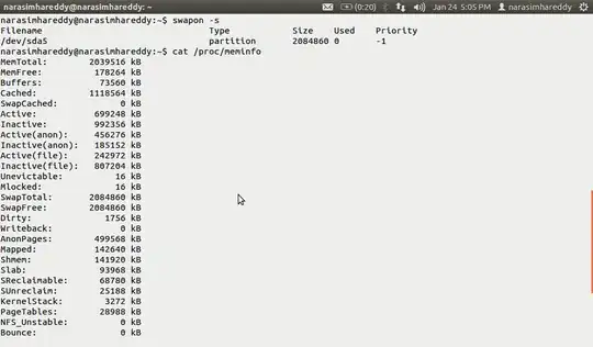

here in the pics i'm giving my system info.

In a default Ubuntu installation you will always have a swap partition which will be created by the installer. In your setup it is the partition /sda5 but this location may change from system to system.
This partition will obviously not be able to increase the physical RAM but it is storage memory on your hard disk reserved for the kernel to use whenever we run short of physical RAM. This may never happen on a system with 2 GB of RAM unless we perform very memory demanding tasks (e.g. video processing, huge image processing) or have many applications running simultaneously.
Note that memory usage on swap is extremely slow, so we do not really want to have that other than in emergency situations.
In case you need a larger swap you can do so after installation either by creating a larger swap partition:
or by adding a swap on a file (which can not be used for hibernation):
