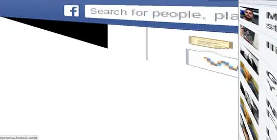

This is a kinda weird question I don't know what to file it under but this is the behaviour I observe when I try to access pages like facebook (it happened once with google as well. Happens with tumblr now too).
This is a new thing so I haven't really tried to figure out which pages trigger this, I just switched to firefox which seems to work ok (because I am in the middle of some work that needs to be done without interruptions.
The first time this occured I left the page open and tried to figure out what happened the whole graphics turned off and it went to terminal.
I recently installed a ram dimm (if you think that might be somehow related)

UPDATE As of Jan 30, 2014, the bug seems to be fixed. With the latest drivers from oibaf's PPA, there are no graphic glitches in Chrome.
Are you using oibaf's ppa with latest graphics drivers? Looks like there's a bug introduced in recent Mesa builds:
Bug 73978 - Intel driver breaks hardware accelerated flash on Chrome (supposedly related to Flash plugin but it's unconfirmed yet).
The current workarounds are:
EITHER: disable accelerated compositing for now in Chrome by launching it with the following flag:
google-chrome --disable-accelerated-compositing

Bad RAM can shift graphic object positions to a different spot. It looks like someone has grabbed one tiny spot on some object in the scene and pulled it to another position. Check if your visual artifacts problem persists if you remove the RAM that you recently installed. Visual artifacts can also be caused by a bad graphics processor, including artifacts that resemble those in your screenshot, however graphics cards often store data in the motherboard RAM, so sometimes it can cause artifacts which look like graphics card RAM problems.1. It can also be caused by dirt or moisture caused by condensation on the connecting surfaces of the graphics card.

If you are using xorg-edgers, then remove this source with the command
sudo ppa-purge ppa:xorg-edgers/ppa
After reboot, and check the Google chrome, it should work
