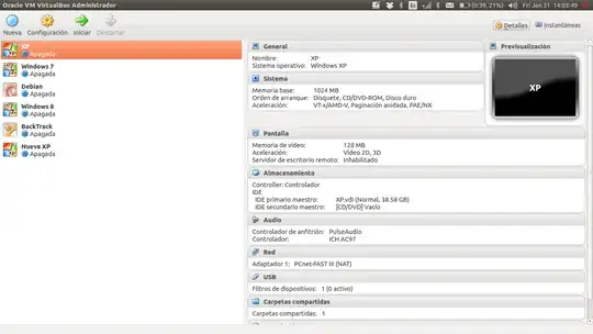

I have a Virtual machine with XP using VirtualBox with the following settings: VirtualBoxSettings

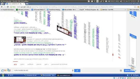

I've tried setting the memory value with a bigger value, but whenever I get the browser it will show something like the following: enter image description here
It is the same using IE.

Solved by disabling the GPU Accelerated Canvas 2D flag in chrome:
  • Access chrome and type about:flags in the address box, hit Enter.
  • Look for GPU Accelerated Canvas 2D and hit on Disable.
