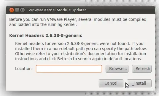

I installed the VMware bundle on my Ubuntu 11.04 successfully but when I open it it gives me this window
and I don't know the path to this C headers.

cd /lib/modules/$(uname -r)/build/include/linux
sudo ln -s ../generated/utsrelease.h
sudo ln -s ../generated/autoconf.h
sudo ln -s ../generated/uapi/linux/version.h
After adding the symlink, the path is /usr/src/linux-headers-$(uname -r)/include (Thanks @Kariem!)
Below commands are very helpful for you:
Step 1 : Ctrl + Alt + T
Step 2 : sudo apt-get install linux-headers-$(uname -r)
Step 3 : The path to the kernel headers is then
Before installing Vmware Workstation you need to install build-essential and linux headers
sudo apt-get install build-essential linux-headers-$(uname -r)
and then
sudo ln -s /usr/src/linux-headers-$(uname -r)/include/generated/uapi/linux/version.h /usr/src/linux-headers-$(uname -r)/include/linux/version.h
Done thats it, install Vmware Workstation now

My first guess is that you haven't installed the headers. You need to install the appropriate linux-headers package. Most likely, you need to install linux-headers-generic. However, if if you're running some kernel other than linux-generic, install the linux-headers package for that kernel.
If you've already installed the headers, they should be in /usr/src.

Had the same issue, I was running kernel 3.2.0-29 but only had linux-headers-3.2.0-35 in /usr/src/
user@ubuntu:/usr/src$ ls -l
drwxr-xr-x 24 root root 4096 Jan 5 11:17 linux-headers-3.2.0-35
drwxr-xr-x 7 root root 4096 Jan 5 11:17 linux-headers-3.2.0-35-generic
user@ubuntu:/usr/src/linux-headers-3.2.0-35/include$ uname -a
Linux ubuntu 3.2.0-29-generic #46-Ubuntu SMP Fri Jul 27 17:03:23 UTC 2012 x86_6 4 x86_64 x86_64 GNU/Linux
user@ubuntu:/usr/src$ sudo apt-get install linux-headers-3.2.0-29-generic
user@ubuntu:/usr/src/$ cd /tmp/vmware-tools-distrib
user@ubuntu:/tmp/vmware-tools-distrib$ sudo ./vmware-install.pl
<kept hitting enter>
Enjoy, --the VMware team
done and done
