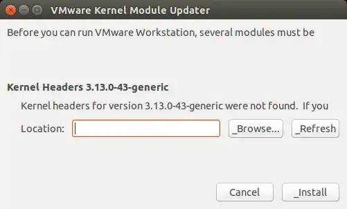

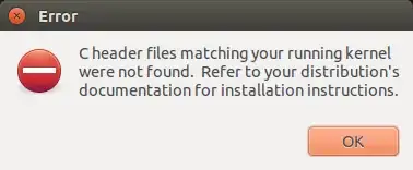

However, upon attempting to run vmware, the following error message box is displayed:
Clicking OK then displays another error message box:

Any idea how to let vmware find the kernel headers and proceed to successful run?

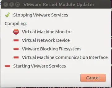

and now I am getting this:

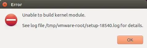

Followed (within 1-2 seconds) by this:
I then followed by (as described in this solution)
cd /usr/lib/vmware/modules/source
tar -xvf vmnet.tar
patch vmnet-only/filter.c < ~/vmnet313.patch
tar -uvf vmnet.tar vmnet-only
rm -r vmnet-only
/usr/bin/vmware
But I am getting the same result ("Unable to build kernel module" error message box).

/tmp/vmware-root/modules/vmmon-only/linux/driver.c: In function ‘init_module’:
/tmp/vmware-root/modules/vmmon-only/linux/driver.c:427:15: error: ‘struct file_operations’ has no member named ‘ioctl’
vmuser_fops.ioctl = LinuxDriver_Ioctl;
/tmp/vmware-root/modules/vmmon-only/linux/driver.c: At top level:
/tmp/vmware-root/modules/vmmon-only/linux/driver.c:771:59: error: ‘SPIN_LOCK_UNLOCKED’ undeclared here (not in a function)
static spinlock_t pollQueueLock __attribute__((unused)) = SPIN_LOCK_UNLOCKED;
/tmp/vmware-root/modules/vmmon-only/linux/driver.c: In function ‘LinuxDriver_Ioctl’:
/tmp/vmware-root/modules/vmmon-only/linux/driver.c:1744:7: error: implicit declaration of function ‘unlock_kernel’ [-Werror=implicit-function-declaration]
unlock_kernel();
/tmp/vmware-root/modules/vmmon-only/linux/driver.c:1751:7: error: implicit declaration of function ‘lock_kernel’ [-Werror=implicit-function-declaration]
lock_kernel();
/tmp/vmware-root/modules/vmmon-only/linux/driver.c:1988:26: error: invalid operands to binary == (have ‘kuid_t’ and ‘kuid_t’)
if (current_euid() == current_uid() &&
/tmp/vmware-root/modules/vmmon-only/linux/driver.c:1989:20: error: invalid operands to binary == (have ‘kuid_t’ and ‘kuid_t’)
current_fsuid() == current_uid() &&
/tmp/vmware-root/modules/vmmon-only/linux/driver.c:1990:26: error: invalid operands to binary == (have ‘kgid_t’ and ‘kgid_t’)
current_egid() == current_gid() &&
/tmp/vmware-root/modules/vmmon-only/linux/driver.c:1991:20: error: invalid operands to binary == (have ‘kgid_t’ and ‘kgid_t’)
current_fsgid() == current_gid()) {
cc1: some warnings being treated as errors
make[2]: *** [/tmp/vmware-root/modules/vmmon-only/linux/driver.o] Error 1
make[1]: *** [_module_/tmp/vmware-root/modules/vmmon-only] Error 2
make[1]: Leaving directory `/usr/src/linux-headers-3.13.0-43-generic'
make: *** [vmmon.ko] Error 2
make: Leaving directory `/tmp/vmware-root/modules/vmmon-only'
Unable to install vmmon
Looks like I should be giving up...
