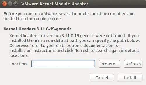

After that, I tried to run the VMWare Player by searching through the search dock and clicking on its icon. I get this window Kernel Headers not found

The installed kernel was obsolete. Its headers is not any more in the repository. So the best thing to do is to update the kernel to last version in the repository.
To enable auto update for the kernel, install linux-generic which is a meta package to keep current version of the kernel & its headers:
sudo apt-get update
sudo apt-get upgrade
sudo apt-get install linux-generic
For some reason this meta wasn't installed while upgrade for you. If it didn't work, then use Synaptic to install its headers or upgrade/install to the last kernel release (search for "linux").
