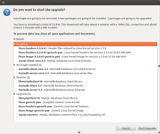

My 12.04 system wants to run a partial upgrade, as part of which it proposes to remove certain MariaDB packages (see screenshot below). Attached is my sources.list file - I don't understand why the system should be proposing the removal of the MariaDB packages, given I have explicitly chosen MariaDB as a replacement for MySQL?

If you are trying a dist-upgrade (seems so?) it may com from Ubuntu commenting out foreign repositories while upgrading to a newer version. Besides that there shouldn't be an incident, where MariaDB is uninstalled (if it wasn't installed as a dependency) automagically.

MariaDB cover this in their article on installing deb packages, best way to fix it is by pinning the MariaDB repo. Which you can do by following these instructions: https://mariadb.com/kb/en/installing-mariadb-deb-files/#pinning-the-mariadb-repository (if you scroll up they also explain why it happens)
