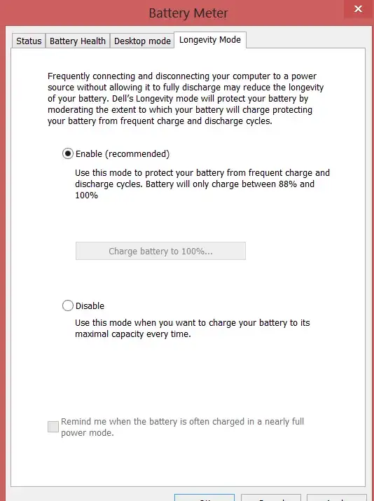

Dell XPS has the following option in Windows 8: I assume it's a hardware switch that is set somehow, so does it stick when rebooting to Ubuntu? Is there a way to check or switch this option from Linux?
I assume there's a driver somewhere since Dell makes the XPS 13, a Linux-preinstalled version of the XPS.
Dell Battery Longevity Mode
