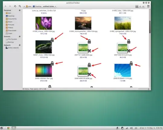

I had a bad habit of storing my wallpapers in /usr/share/backgrounds, and decided to move them all into Pictures. Well, the problem is that most of them are now read-only since they are owned by root. How can I become the owner of them, if root already owns them? I have already tried How can I become the owner of a file that origins from another pc / user?, but the settings do not "stick".

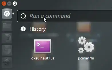

Press ALT+F2 and type gksu nautilus This will turn you into an admin account using nautilus. Now go to those files and change the permissions/owner so your normal account can use them. This sometimes not work. At least for me they work and in another PC do not. Test and see.
The GUI version looks almost the same as Dash, except that instead of saying "Search" in the search bar it says "Run a command". Here is an image:

edit: after reading the link you posted I have a question! Did that topic not already answer your question? It talks about executing gksu nautilus. This option lets you use Nautilus as a root user. That would allow you to change access (see the picture in that topic).
