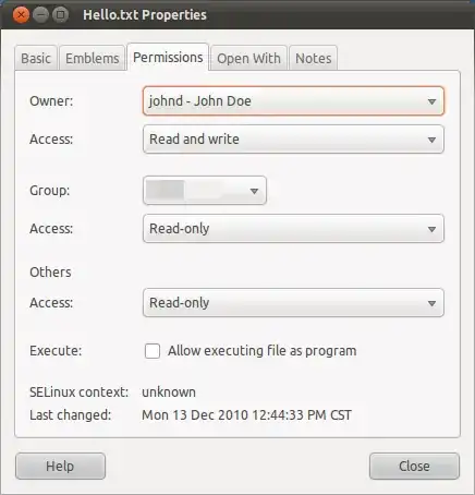

GUI instructions:
Run Nautilus with sudo privileges
  • Alt+F2
  • Enter gksu nautilus.
  • Enter your password.
  • Now you can right-click on a file, go to the Permissions tab and select the new owner from the Owner combobox.
