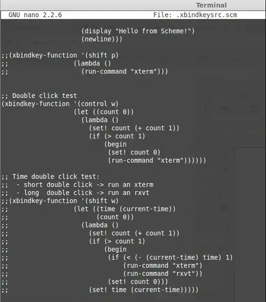

The correct solution was to uninstall everything that was associated with xbindkeys

I fixed it, I eventually came across a file called .xbindkeysrc.scm located at ~/.xbindkeysrc.scm. So I went through and commented out anything pertaining to Shift + w and Shift + p and then restarted. Everything is back to normal now.
