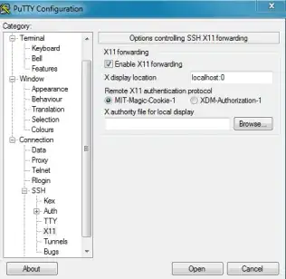

**Configuring Putty
  1. Add Unix hostname
  2. Switch Protocol to SSH
  3. Type name of session in saved sessions
  4. Click 'Save'
  1. Expand the 'SSH' tab from the 'Category' list
  2. Choose 'X11' from 'SSH' list
  3. Check 'Enable X11 Forwarding'
  1. Choose 'Session' from 'Category' list
  2. Click 'Save'
