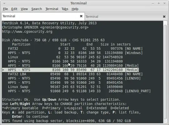

I'm trying to recover my data after a bad installation. On my laptop I had 2 partitions: Windows and Media. Now I'm trying to recover the content of the Media partition and this is what the amazing TestDisk has found: 2 Media partitions.
I don't know which should be the next step and I'm afraid to do experiments in order to no loose all my data from Media partition.

Its obvious to show two partitions and maybe more... that is due to making the same partition before the current state with the same characteristics but differ in the end sector.
Anyway, You are making recovery so why you are afraid?!
Just move on and choose anyway one. when the recovery process is complete the testdisk will prompt you with the result and asks you were to save the recovered data...
What i wanna say to you that testdisk will not write to the recovered partition so even you choose a wrong one, this will not hurt your data.. so you can choose the other then.
