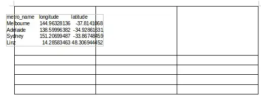

I am trying to copy/paste a 4 column table from LibreOffice Calc to LibreOffice Writer but when I paste it, it makes a table extraction from Calc. I also created a table in LibreOffice Writer using the Table tool in Writer an tried to paste the data from the Calc Table into the Writer Table. It created yet the same thing, another Calc Table copy.
So how can I grab the content of a 4 column table in Calc and paste it in a 4 column table from Writer.

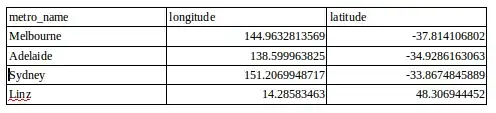

Copy the sample data in Calc.
If you try to directly paste into your original table all infos will be pasted into the first cell instead of several columns or rows, respectively.
Instead put the cursor in an empty space in the document, e.g. a normal paragraph not a cell in a table.
In the Writer menu select Edit -> Paste Special (Ctrl + Shift + V) and then select "Formatted Text".
Now you will see your table from Calc pasted into Writer.
In the next step you can now select this table and copy and paste it into your original table.
Voila!
The advantage of this method is that you don't have to fix the bad formatting of paste special.

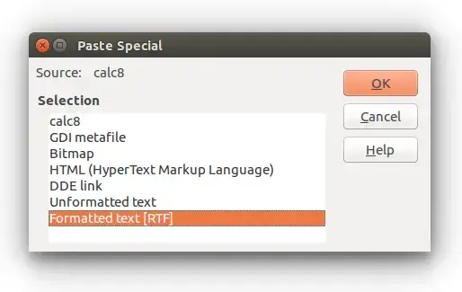

Can I suggest, in Writer, choose Edit - Paste Special. Then select "Formatted Text". This will paste the text in a table which you can then format/add borders etc.

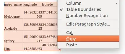

My preferred way to paste (formatted) tables from Calc to Writer is via the HTML editor of LibreOffice. Do this:
  1. Copy the table from Calc,
  2. Paste it in the HTML editor,
  3. Copy again,
  4. Paste it in writer.
You will have your table pasted as a table (with the right number of columns and rows) and with a good part of formatting conserved.

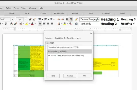

In LibreOffice version 7 you can do Paste Special > More Options > [and select the image format you need]
Paste image format dialog
