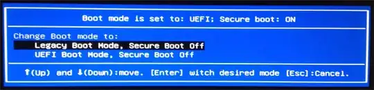

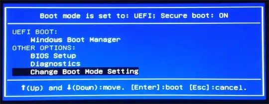

  2. Then in order to be able to boot from the USB I had to change the BIOS Boot Mode Setting to Legacy Boot Mode, Secure Boot Off change the BIOS boot mode Legacy Boot Mode, Secure Boot Off

  7. Then I clicked the "Recommended repair" button. In this step I got a little worried when prompted to choose Yes or No to the message "The boot of your PC is in Legacy mode. You may want to retry after changing it to EFI mode.". It turns out I had to click Yes or the boot-repair would not run. After a little wait boot-repair did its magic and when it finished I took note of the URL as instructed.
  8. Finally I changed the BIOS Boot Mode Setting back to what it was before I started. Rebooted and boom! Everything was back to normal.
