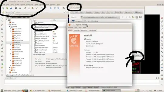

I finally got it to work under Ubuntu 11.04 64 bit.
First follow detailed instruction (one of above since pretty much any method will work). Don't forget to put all dependencies
Believe me or not after I installed it I had to delete configuration files in home directory which are starting with "." or move them to some folder if you have wine app or something like that.
For people which doesn't like this idea, to delete configuration files, try to create another user account and run it from there.
After that I found out that enabled **buttons have icons application will crach when i try for example to click on Open.**
and that's it for now. When I get more knowlegde i will postenter image description here
BSimulj
  • 227
