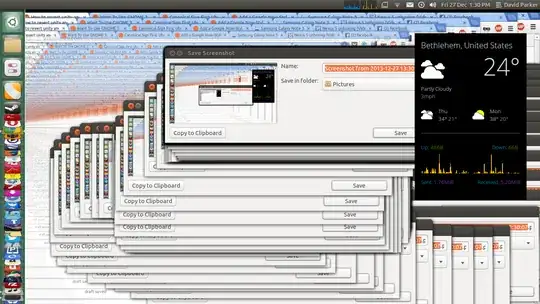

After reboot , weird things started happening :
  • Gnome desktop always crashes (hang and unusable)
  • no mouse cursor in unity and login window
  • Mouse scrool act opposite
  • wallpaper is now gone ! Even applying new pic as wallpaper didn't solve
  • horrible graphics
