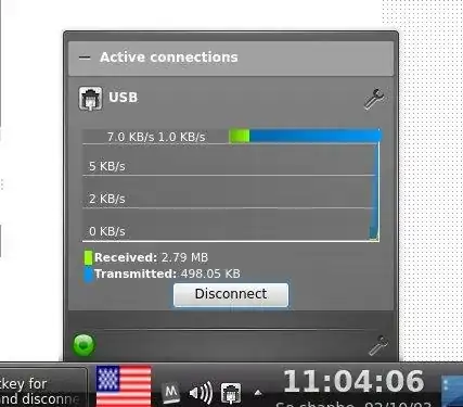

Disconnecting from the current network connection and staying disconnected:
qdbus --system --literal org.freedesktop.NetworkManager /org/freedesktop/NetworkManager/Devices/0 org.freedesktop.NetworkManager.Device.Disconnect

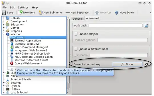

Hotkeys
One way to add the shortcuts/hotkeys is to use the KDE menu editor.
The command can be added to the KDE menu with a shortcut to run the command.
The KDE document can be found: K-Menu > Applications > Help ...
The KDE menu editor handbook on the net: http://docs.kde.org/development/en/kde-workspace/kmenuedit/index.html

And these are what I use to disconnect:
$ nmcli dev status
$ nmcli dev disconnect iface eth1

To give it a toggling nature which is needed to set a single hotkey for both enabling and disabling, probably a C++ code is appropriate for combining and automating these commands (time-consuming for me). Two hotkeys amy be better for me. I use this method for setting a hotkey for a command:
https://askubuntu.com/a/393343/126106
