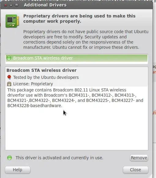

So, I thought it to be a driver problem and, surely enough, I found in "Additional Drivers" that it was lacking in a Broadcom® STA wireless driver. Unfortunately, getting the driver didn't fix it, either. It still cannot detect anything.

I installed all 4 entries under the keyword "bcm4311": firmware-b43-installer, bcmwl-kernel-source, broadcom-sta-common, and broadcom-sta-source. (There is even b43-fwcutter, though that appears for the broader keywork "bcm".) The problems is still there.
Additional Drivers reports: "This driver is activated and currently in use."

Basically check on additional driver section if it is in use or not.
Try ifconfig or iwconfig to see if you have a wireless interface or not. Sometimes you may need to install an alternative broadcom driver if the additional drivers recommendation fails. Try different broadcom option from Synaptic Package Manager with search keyword bcm4311. Or follow more instructions here.
