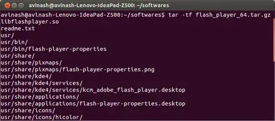

Run the below command in the terminal to see the contents of a tar.gz file without extracting it:
tar -tf filename.tar.gz
screenshot of listing compressed tarball files in the terminal
-t, --list
List the contents of an archive. Arguments are optional. When given, they specify the names of the members to list.
-f, --file=ARCHIVE Use archive file or device ARCHIVE...

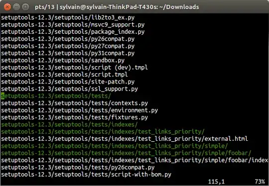

You can also use vim
vim filename.tar.gz

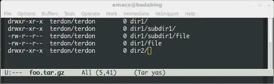

And since someone mentioned that lesser editor, naturally, emacs can also do this:
emacs showing an archive's contents

Why not use vim to browse your archive and open files (at least text-like files):
vim archive.tar.gz
Press the arrow keys to scroll and Enter to open a file.
