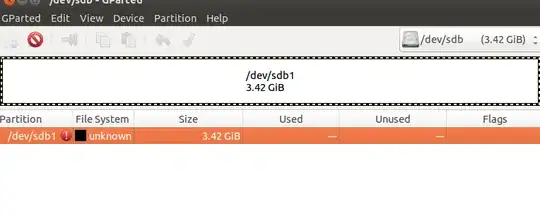

Just use GParted. GParted
Unmount all the partitions on the USB stick, and then delete them. You can then create partitions as you like. The is some documentation here if you need any.
This should effectively wipe any partitions. - remember to click this green button, or it won't do anything:

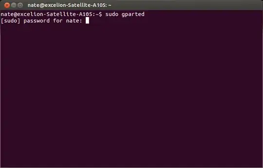

Simple! Start up gparted via the terminal (Ctrl+Alt+T) and entering sudo gparted
terminal.

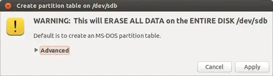

  1. Go to Device>Create Partition Table This window will come up:
new partition window
click Apply . You may have to also start this process by clicking the check-mark button.
This will create a new partition table and will make the data unrecoverable by most people.
