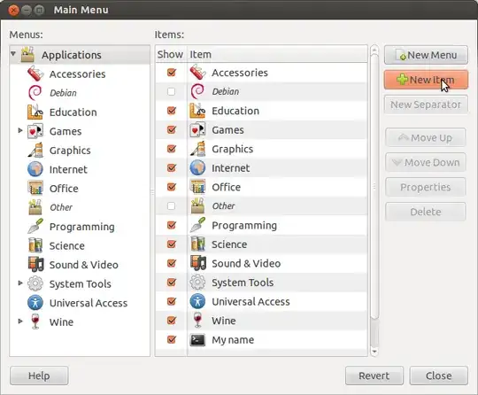

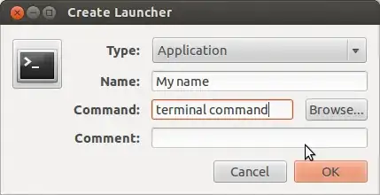

There is a program called "main menu" available from the software centre. It allows you to make launchers for any command.
Also you need to run the cd and the launch as one command like this:
sh -c "cd /folder/to/go/to  && launch-command -options"
Click new item Click new item
Enter a name for the launcher and the command, and maybe a picture Enter a name for the launcher and the command, and maybe a picture
