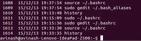

106
Open terminalCtrl+Alt+T and run,
HISTTIMEFORMAT="%d/%m/%y %T "
then,
history
To make the changes permanent follow the below steps,
gedit ~/.bashrc
you need to add the below line to .bashrc file and then save it,
export HISTTIMEFORMAT="%d/%m/%y %T "
run the below command to source .bashrc file,
source ~/.bashrc
After that run history command.
source:http://www.cyberciti.biz/faq/unix-linux-bash-history-display-date-time/

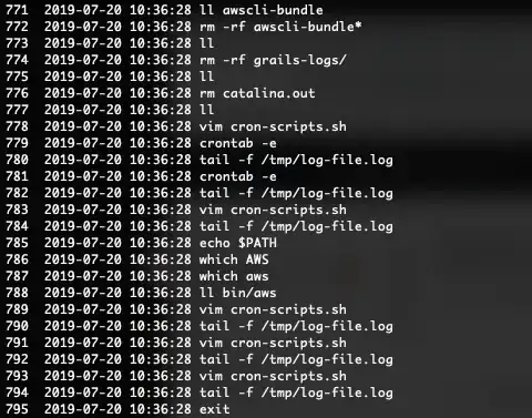

My version that works
HISTTIMEFORMAT="%F %T %z " history | grep 'your command'
ref. https://www.linuxuprising.com/2019/07/bash-history-how-to-show-timestamp-when.html
E.g.
╭you@your-server:/some/path
╰$ HISTTIMEFORMAT="%F %T %z "; history | grep 'some command'
 1947  2019-12-17 15:54:34 +0800 ./some.sh
 1948  2019-12-17 15:54:34 +0800 ./my-command
View full syntax for HISTTIMEFORMAT here
