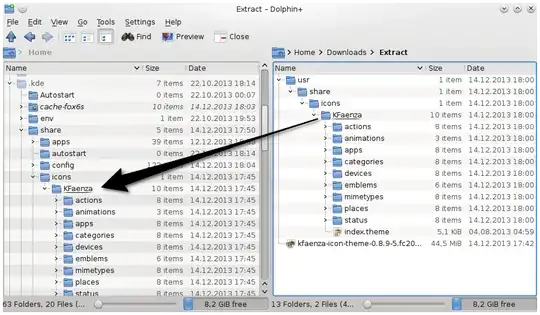

The unpacked KFaenza folder then has to be copied over into ~/.kde/share/icons/ to make it available:
Copying the unpacked KFaenza theme with Dolphin

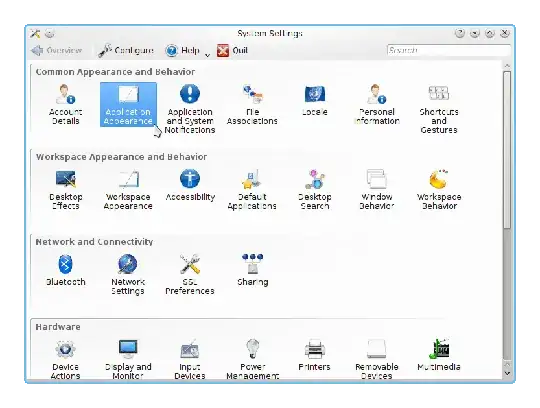

Now the KFaenza theme can be picked from the KDE System SettingsApplication AppearanceIcons. Apply the change, and the KFaenza is there!
Applying the theme in the system settings
