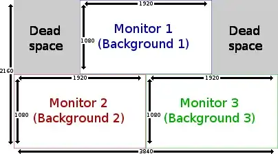

So I have a triple-monitor setup. Basically what I want is simply to have a different background on each of the three monitors. Now I am not speaking about different virtual desktops (aka workspaces) here. Most of the solutions I googled were about different backgrounds on different workspaces. I have only the one workspace, but three monitors, like so:
Monitor 1 (on top) is my big TV that's attached to the wall above my two normal monitors.

The workaround I have gone with so far is to use Gimp to create one "big" background that encompasses the entire virtual resolution of all three monitors together. Basically, I create one big background image of size 3840x2160, in which I paste three backgrounds at the right places. Then I set this big background as the single background for the three monitors using possibility (1) or (3) above, and use the span option to span this big background across all three monitors. This results in three different backgrounds on the three monitors, provided the three smaller backgrounds were placed correctly on the big background image (Note: possibility (2) does not offer a span option).

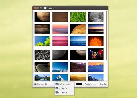

You can use nitrogen
To install it, run the following command in terminal:
sudo apt-get install nitrogen
Because nitrogen doesn't have a desktop file by default when is installed, you need to run the following command from terminal to start it:
nitrogen
How to use it?
In it's Preferences, add your wallpaper folder, then at the bottom [...] select Screen 1, 2, etc., to set a different wallpaper for each monitor:
nitrogen
To be able to set a different wallpaper for each monitor, you must disable the file manager from handling the desktop. This means you'll no longer have folders on the desktop.

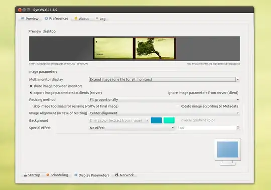

The default Ubuntu Appearance settings doesn't let you span a single large wallpaper across both monitors or use a different wallpaper for each monitor, but there are two applications that you can use to do this.
  1. The first one is SyncWall. Install it in Ubuntu using the following commands:
    sudo add-apt-repository ppa:nilarimogard/webupd8
    sudo apt-get update
    sudo apt-get install syncwall

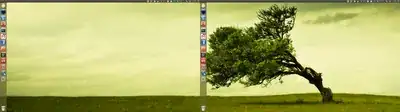

    Here's how my desktops looks like after using SyncWall:

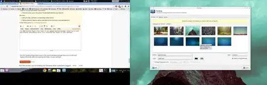

the XFCE Desktop Manager Plugin (that comes in the xubuntu-desktop package) allows you to edit each display individually while still retaining the folders on your desktops.
A screenshot of my 2 desktops with the manager open : https://i.sstatic.net/Bzg7G.jpg
in the yellow box it says "Move this dialog to the display you want to edit the settings for."
I'm sorry i cant be more help as to giving instruction on to how to install it, nor what the actual plug in is called ( I tried to find it but decided to re-install the whole package instead ) - But hopefully this leads you or somebody on the right track, and this answer can be improved through edits.
