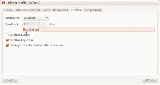

Like David Purdue suggests, I myself too. I like to have unlimited scrolling.
editTerminalProfile
You can also enable the scrollbar if you want; but I prefer it disabled and use Shift + Page Up and Shift + Page Down keys to change the output frames.

If you are using the standard Terminal program on a Desktop version of Ubuntu...
  1. Choose Edit -> Profile Preferences from the terminal windows global menu.
  2. Choose the Scrolling tab
  3. Set Scrollback to the desired number of lines (or check the Unlimited box).
Then you can use the scrollbar at the side of the terminal to scroll back through the lengthy command output.

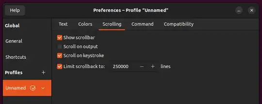

Ubuntu 22.04
The default number of scroll back lines in Ubuntu 22.04 is 10000. You can change this to any number up to 2147483647 or disable it altogether. Both can be done either from the GUI or from the command line.
From the GUI
Open Terminal -> Settings (the hamburger button) -> Preference -> Profiles -> Unnamed -> Scrolling. There you will see Limit scrollback to. You can either disable it altogether or change the number of lines you want to scroll back like this:
Preferences - Profile Unnamed
From Command Line
The same thing can be done from the command line, using gsettings. Read more about how this works in this post: How to change gnome-terminal scrollback lines from command line.
Enable unlimited scrollback:
gsettings set org.gnome.Terminal.Legacy.Profile:/org/gnome/terminal/legacy/profiles:/:$(gsettings get org.gnome.Terminal.ProfilesList default | tr -d \')/ scrollback-unlimited true
Limit scrollback to 250,000 lines:
gsettings set org.gnome.Terminal.Legacy.Profile:/org/gnome/terminal/legacy/profiles:/:$(gsettings get org.gnome.Terminal.ProfilesList default | tr -d \')/ scrollback-lines 250000
