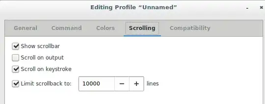

All this is to say that your terminal's history is probably saved using a trick like that, somewhere in a deleted file in /tmp. What you probably actually want is to simply increase the scrollback buffer size of youre terminal emulator so you can just scroll up and see it. The details of how to do this depend ont he terminal emulator you are using. Most have a command line switch that lets yous et this and many also have a GUI way of setting it. For example, in gnome-terminal (the default on Ubuntu) it's Edit -> Preferences -> Profiles --- click on your profile --> Edit -> Scrolling -> Limit scrollback to NNN:
gnome-terminal options screen
