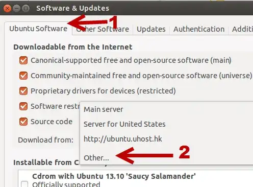

I changed my download server and it worked like charm. Here is how you can do it
1.Open 'software and updates' and click the 'Ubuntu Software' tab.
  1. Click 'Download from' and choose 'Other' enter image description here
  2. Click 'Select Best Server'. Ubuntu will take some time to select the best server for you. Accept it.
  3. Now try running the software update again. It should work.
  4. If it does not go through steps 1-4 again. This time Ubuntu will (hopefully) select a different server as the 'Best server'. Try software update again.
THE KEY IS TO CHANGE THE DOWNLOAD SERVER FROM WHERE UBUNTU UPDATES ITSELF.
