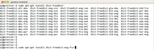

For offline use:
You can install dictd server and use Freedict Dictionary database for word translations.
Install dictd:
sudo apt-get install dictd
dictd
Install translation database. eg. dict-freedict-eng-fra for English to French translation, dict-freedict-eng-spa for English to Spanish translation.
sudo apt-get install dict-freedict-eng-fra
sudo apt-get install dict-freedict-eng-spa
freedictDB

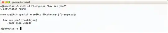

Usage:
View list of databases:
dict -D
Use a particular database eg. for English to Spanish translation:
dict -d fd-eng-spa "how are you?"

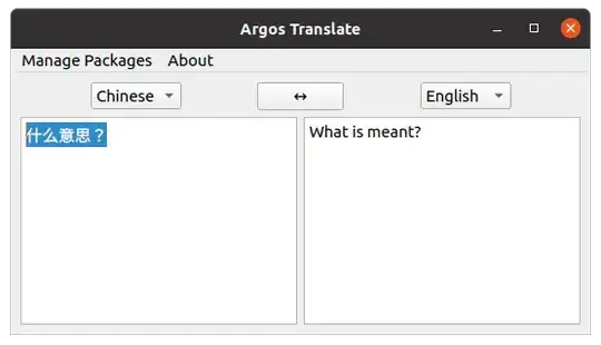

There is also a GUI which is cute but a bit useless, and takes up another 5 GB of disk space:
argos-translate-gui
pipx install argostranslategui==1.6.5

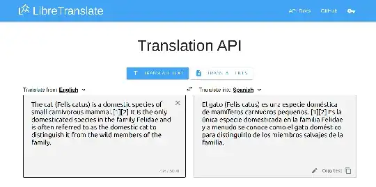

LibreTranslate
https://github.com/LibreTranslate/LibreTranslate
Apparently a server built on top of Argos?
Doesn't seem to be very useful for single users, but the point of this is likely to be able to self-host a Google Translate-like translation server/webpage internally for a company, without making everyone setup Argos individually on their machines.
