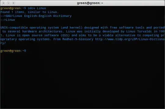

sdcv is the console version of Stardict.
1. Install the dictionary
Run the following command in the terminal:
sudo apt-get install sdcv
2. Download dictionary files
Download the dictionary files according to your requirements from the following sources.
3. Install downloaded dictionaries
Make the directory where sdcv looks for the dictionary:
sudo mkdir -p /usr/share/stardict/dic/
The next command depends on whether the downloaded file is a .gz file or a .bz2 file.
If it is a .bz2 file:
sudo tar -xvjf downloaded.tar.bz2 -C /usr/share/stardict/dic
If it is a .gz file:
sudo tar -xvzf downlaoded.tar.gz -C /usr/share/stardict/dic
4. Done!
To search for a word use:
sdcv word
