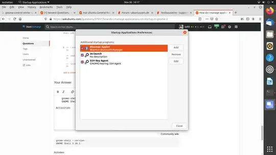

ubuntu groovy
gnome-shell --version
GNOME Shell 3.38.1
Activities search
and
startup applications

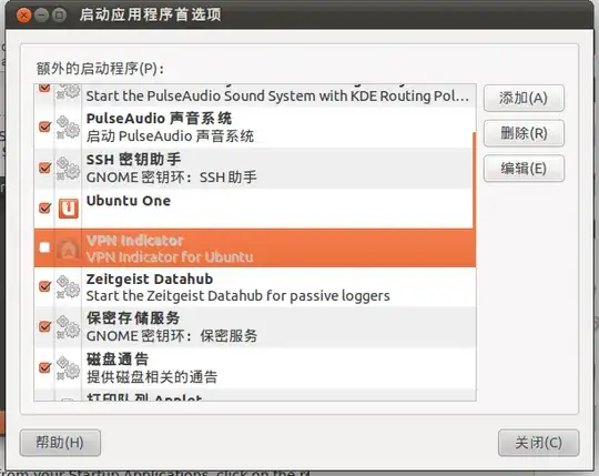

  1. To access System Settings, click the "Power" icon at the top right corner of the desktop and select "Sytem Settings". Under the "Personal" heading, click on "Startup Applications." This is the same GUI from previous versions of Ubuntu and Gnome.
    系统设置开始
  2. To remove Pidgin from your Startup Applications, click on the row that says "Pidgin" in the list. Then, click the "Remove" button on the right, which will remove the entry altogether. Alternatively, you can disable the program from starting when you log in by simply unchecking the checkbox on the far left. This would allow you to re-check the box in the future, to re-enable Pidgin as a Startup Application.

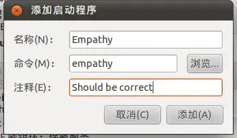

  3. To add Empathy to your Startup Applications, click the "Add" button. Choose a Name, such as "Empathy". It can be anything you like. Next to Command, type empathy. This will launch an Empathy window after you log in. If you would prefer to have Empathy start hidden in the Messaging Menu, enter the command empathy -h instead. Next to Comment, you can leave blank or you can add a descriptive comment. Then click Add.
    Empathy开始
