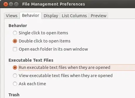

Its just a setting in the file browser Nautilus. Go to Edit > Preferences > Behaviour
Choose Run executable... to run an application on opening. To avoid running an application unwantedly it is however better to choose Ask each time.
