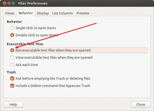

Open the file manager, go to the Files menu and select Preferences to open the "Preferences" dialog.
In the Behaviour tab activate the option Run executable text files when they are opened in the Exexcutable Text Files section:
Note that this may cause you to run potential harmful code instead of opening it in a text editor. So it's usually better to activate Ask each time instead.
