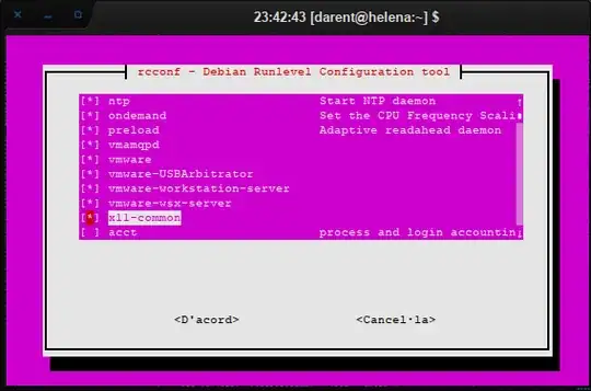

You can simply disable X from startup. Install rcconf:
sudo apt-get install rcconf
Run it with sudo:
sudo rcconf
And search for the entry x11-common, disable it and select OK. Then reboot.
If you ever change your mind, Xorg will be still installed, but it won't load on startup so you just need to re-run rcconf and re-enable x11-common.
