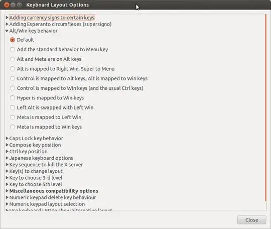

Keyboard manager settings shows the below but doesn't seem to help me.

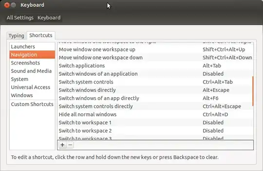

Also keyboard shortcuts shows:
but alt-f6 doesn't work

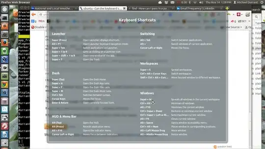

Pressing the Super key or the Windows Key key only for 2-3 seconds brings up the "Keyboard Shortcuts" window that shows the system's keyboard shortcuts.
Combinations shown using Super key:
shortcut overview screenshot

You can use Alt + Esc to switch between windows immediately. It's more ordered than the default method but doesn't show you a list of windows.

To show the keyboard shortcuts window, press (and hold) the super key (on my keyboard, this key had a Windows logo printed on it).
