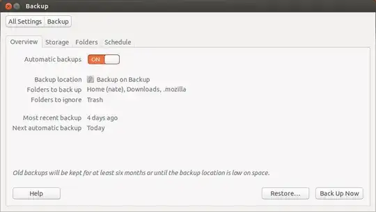

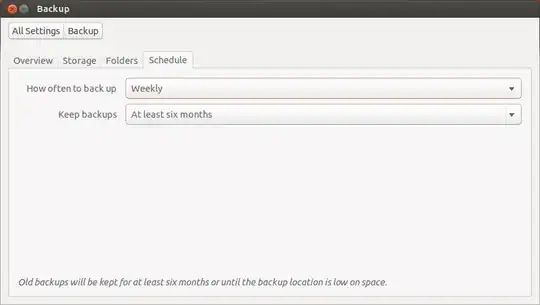

However, when it goes to automatically backup it says that there is no space left. I have my backup settings set to this:
Backup Screenshot 1 Backup Screenshot 2
and it says that old backups will be kept until backup location is low on space. Why isn't it deleting old backups if it doesn't have enough space? Is it too low in the backup directory (again, delete old backups) or is it a problem with my /tmp or ~/.cache?

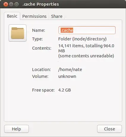

I looked at this question: Why does Déjà Dup say there is no space left?, but that didn't help any. AFAIK my tmp folder and my .cache folder aren't too large:
tmp folder specs .cache folder specs
