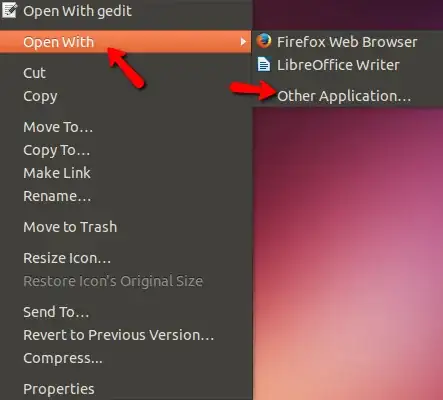

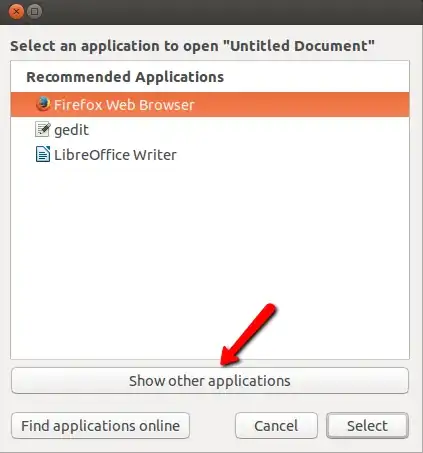

Another way to Open With is to right click on the desired file, and choose Open With, and then pick the application or choose Other Application, and click on Show other applications, and browse for more. See images below.
