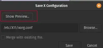

2) Grab the X Configuration settings
A popup appears, click "Show Preview" enter image description here
Copy the preview text into an editor.

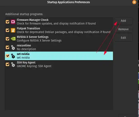

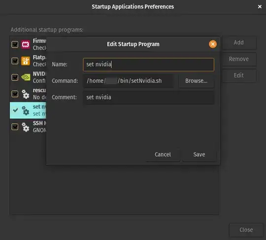

6) Set startup applications
Next, set the permissions of the script
sudo chmod u+x ~/bin/nvidiaStartup.sh
To access start startup settings:
gnome-session-properties
press add enter image description here
Now it will start up each time you load your OS.
