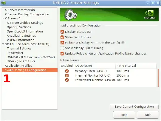

I was able to solve this problem on my system:
  1. Navigate to "nvidia-settings Configuration" tab.
  2. Uncheck "Include X Display Names in the Config File"
  3. Save Current Configuration
It turns out the settings were getting loaded, but the display names (which looked right) were preventing them from being set. This was on a basic dual display system.
